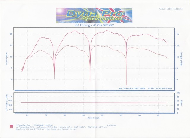

RB Graph:-
wedge001.jpg [ 51.13 KiB | 被瀏覽 8974 次 ]

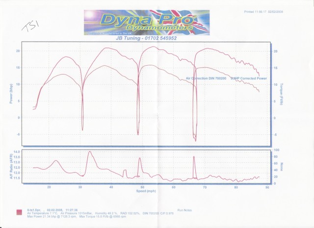

TS1 Graph:-
wedge002.jpg [ 53.86 KiB | 被瀏覽 8974 次 ]

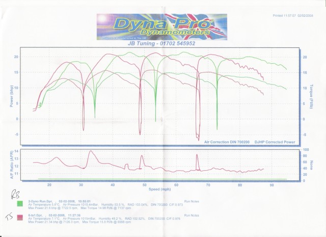

Comparison Graph:-
wedge003.jpg [ 60.1 KiB | 被瀏覽 8974 次 ]
The RB made 21.6bhp @ 7722rpm with 15Ft/lb torque @ 7137rpm
The TS1 made 21.3bhp @ 7126rpm with 15.8 Ft/lb torque @ 6988rpm
You may consider these figures to be pretty low, but bear in mind the JB tuning dyno is the lowest reading dyno being used by any UK scooter tuner.
If you read the dyno comparison article in the February edition of Scootering you'll see that these figures would raise to around 26bhp on Readspeed's dyno.

有沒有人可以解釋一下
你貼的很清楚
我看的很模糊
哈哈哈
